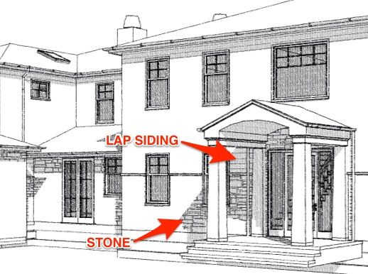

Scratching my head. When sketch rendering, the vectorial hatching only shows in shadow areas. (see image below) I've tried every setting I can think of with no success. What's really annoying, is I have not had this problem in the past--all past renderings have been fine and I thought I was using the same settings. (see second image) Baffled...

This is not intended, it is definitely a bug. Graphic Overrides should affect 3D Views and Renders, but only their Surface Overrides! Fill Overrides should have no effect on them at all.
I have let the developers know, hopefully we can fix this soon!

Just ran into this today on an AC 23 project that I had made no changes to the Graphic Overrides in weeks. The Override was Zone Fills- Empty. The solution was having No Overrides selected. An unfortunate bug on the day you are submitting.
