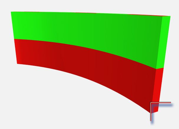

Yes: map this to a material size the height of your wall.
Dwight Atkinson
Dwight
Stripe on wall
Dwight Atkinson
Dwight

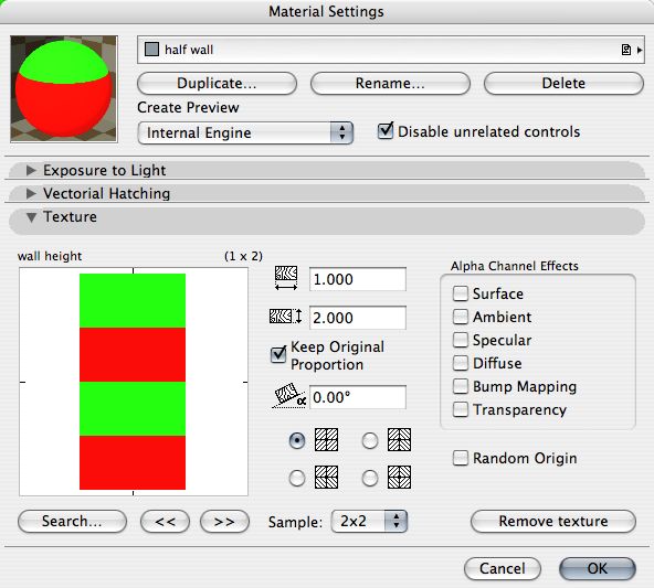

The settings, starting with the Internal engine.
It is mapped to the height of the wall, in this case 2.0 m.
Use 3D align to position it exactly to match the sill position.
