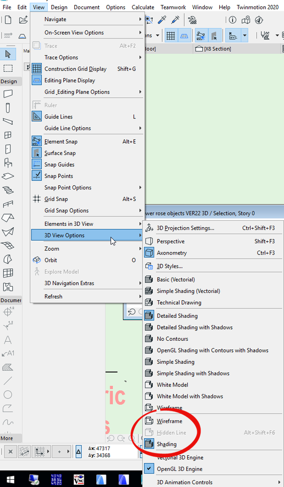

Yes, sorry that was my custom Work Environment menus.

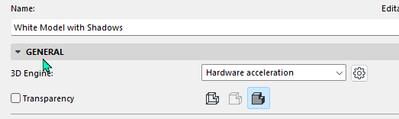

I see you are not set to wireframe in the 3D styles.

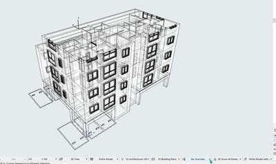

Check your Graphic Overrides aren't changing all surfaces to a transparent material.
GOC is No Overrides
I use it like this now.
AC27 on window 11
It really looks like there is some kind of override as it is not 100% transparent.
Looks like a glass surface.
But your transparency is off, so even glass should appear solid, not transparent.

I see your Renovation filter is set to '00 Show all elements', but open the settings and make sure it is all set to 'Show' and not "Override".

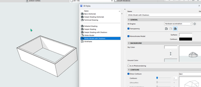

New File
Because it suddenly happened...
I think it's a bug.

If you change the 3D engine from 'Hardware Acceleration' to 'Vectorial Engine' (in 3D styles), does that make any difference.
Have you closed and re-opened this file?
What happens if you copy from one file to the other (try both ways)?
this is hotlink
AC27 on window 11
So hotlinking part of the 'wireframe' model into another file - it all looks OK.
That to me says the model is OK.
The surface materials in the 'wireframe' model have all been changed to become transparent (check the surface materials settings - do they look normal) or there is a setting that is overriding the surfaces - graphic override, renovation filter or some other setting we have overlooked.
Try taking those 4 walls from the other file and bring them into the 'wireframe' file - either copy & paste or by hotlink.
If they turn wireframe as well then I suspect something has overridden the surface materials.
What that is I can't say as I don't have the file.
