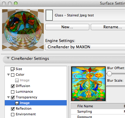

This is a great learning exercise. Glad you brought it up here. Setting the image of the stained glass to be in the transparency channel works for me in preview. I'm still waiting for the final render to generate though...
...and, I have no idea how to align the image to the desired position within the glass...

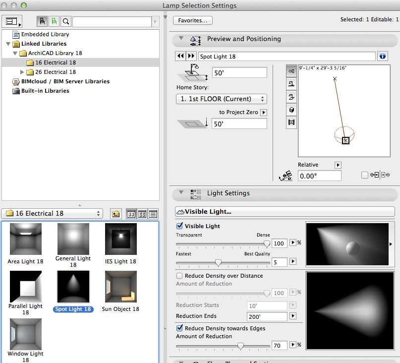

I used the Spot Light 18. It and just a few others allow for visible light.
Yeah, only used the image for transparency as in prior screenshot of surface settings.
