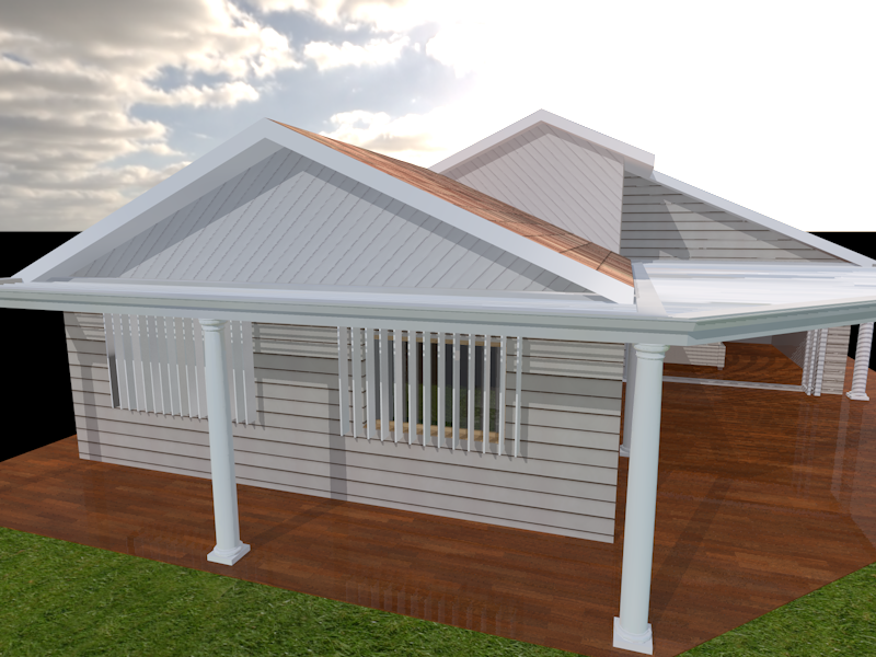

Hi all,
I'm having trouble with a surface finish applied to a wall; it appears vertical in the model but is rotated 45 degrees in the render.  Note the upper walls are also rotated in different directions, and sometimes it happens in elevation too. I hope it's just a rookie mistake...
Cheers,
Rob.
Operating system used: Windows 5003 Aus edu
1 Solution
It could be that your Cinerender/Redshift surface settings don't match the basic/hardware acceleration surface settings.
