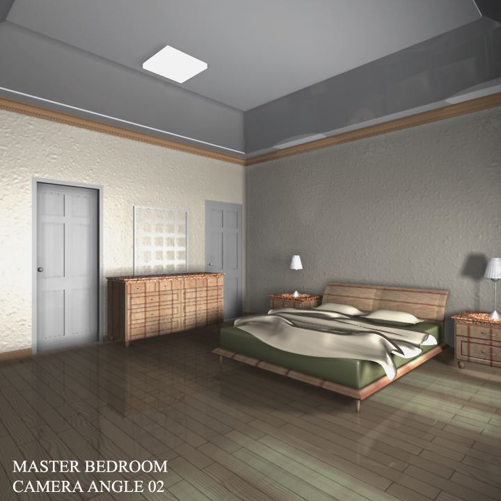

Work in progress but i need some help u guys

this is a good start.
--- change light color to combination of warm and cool.
-- uplight ceiling through undersun - manual -90 degree sunobject with shadows off.
--- increase roughness on walls to .01,.01, 1,1
this and 208 full color pages more in "LightWorks in ArchiCAD" available by air mail from me as detailed below.

Dwight, I was wondering how i can make that light fixture on the ceiling show its edges while still having some light generated from it. I have a few other camera angles that i have to post. My biggest problem is to assign a mirror reflectance to my suppose to be mirror on the wall.

1: Ceiling light fixture edge definition:
-- use a large light cone down to make light energy instead.
-- place a small slab against the ceiling to stand in for your fixture with a material of constant reflectance on the top and bottom and plain white on the edges. For really fancy effects, use Emission.
2: Mirror: There's a mirror shader in the Surface definitions.
All this and more in the book. But you know that.
