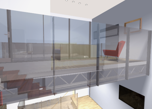

Original tinted glass - I don't quite understand the effect you are after, but have wanted a frosted glass for some time...

__archiben
andyro wrote:
Do you mean like this?
yep - more like your 'milky white plastic'. does it have a window light behind it to accentuate the translucency?
i was aiming for a two-skin polycarbonate cladding system. i wanted to see if i could render the translucency before i tried to apply the 'ribbed' effect.
the thing that i dislike about your 'milky white plastic' is the dull grey area in the bottom left - out of direct light. i found that when i boosted the specular or reflectance to compensate, i lost the transmission . . . and with it any translucency i had achieved. by then i had more deadlines to meet so gave up . . .

Andy Thomson
Hm. Well, all I can say is LW in AC kinda sucks. I have endeavored with it because it is nice that it is just there, and had a meeting tonight where the clients were just floored, by the design and the renderings, but this job is going immediately to Studio or C4D, I too have given up! Again - too many freaking parameters in the LW material interface, and no way to see what the effect is (that tiny litlle preview sphere - is that a joke?) It should be a 4cm (actual) cube!!

Andy Thomson
I've since made a bunch of improvements - you can fine tune to get exactly what you are after, most of the coloured glass casts coloured shadows now too, look for the 'Translucent White' or Milky White plastics.
Just 'append' the .AAT to your file using attribute manager.

__archiben
Long wrote:
do you mind posting the setup of your translucent milky glass?
long tran,
download the file andy posted above and use your attribute manager to append them to your project file . . . you will then see new materials available to you that andy has already set up - and their settings will be available to you in the materials editor.
andy's included all of his glass materials (08 | <....>) as well as the translucent plastics (06 | <....>). the one you're looking for is called '06 | PE Milky Translucent'
