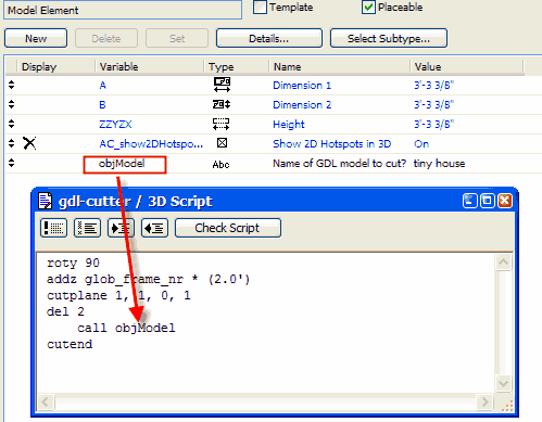

I figured I'd try the old GDL method that Laszlo outlined...and I cannot get it to work in 11 either.
Attached is a screenshot of the simple object. Mostly a hack for testing. Works fine in the GDL 3D window as I manually vary the cutplane position to simulate the animation.
The 'tiny house' shows up fine in the 3D window. But, if I generate an animation, it doesn't show at all. I have a terrain slab under it that's all that I see in the animation.
Pretty weird/buggy behavior, but I've got to move on... Artlantis Studio is so easy for this stuff!
While waking up this morning, I wondered if the problem was the OpenGL window. It was. When I use the internal engine, the old cutplane / object method works!
Attached is a QuickTime movie created from the internal engine 3D window showing that the object shown in the screenshot below works. Did not want to take the time to verify if LightWorks worked as well...
The SEOp method still does not work: SEOps are not updated during rebuilds of an animation.

Latest update: the cutting plane method does work in OpenGL after all. So, this method seems to work in all modes. The only 'problem'/hassle is that you have to save the model to be cut as a GDL object.
I've had no OpenGL problems at all on my 3 year old desktop with ATI Radeon 9700 Pro card. Have been running with a driver from this past summer. So, it did not seem likely that it was a display driver problem when the cutting (seen in the movie in the last post) was not seen in the OpenGL window but only the Internal Engine 3D window.
But, running something else today cause a BSD (blue screen of death) pointing to the ATI driver. I downloaded the new drivers that were posted on the ATI site this month...and the cut plane animation works fine now. Could be something related to the November Windows updates, as GS tech had posted elsewhere.
