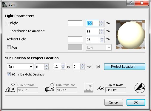

Erwin Edel
Rockstar
Internal engine uses the internal sun settings (see below), cinerender does not use that.
As you can see, I've set the sunlight and ambient light to pure white there as I got 'tired' of having to adjust for the colouring in openGL view/internal engine.
Cinerender is a very advanced renderer, which sometimes, unfortunately, means there are a lot of settings to adjust.
Maybe start by ticking off settings in the detailed settings to see what is affecting the colour the most.
