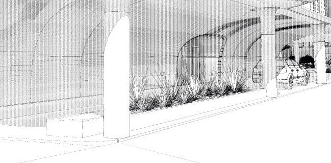

I am trying to do a sketch render and an object imported from Rhino is showing some of the mesh lines when I render.
Does anybody know how to resolve this?

I mostly see a lot of shadow lines, those you can turn off easily in the render settings.
To hide any unwanted edges, you'll either have to convert it to morph and manually set these to hidden or change the status codes accordingly in the GDL script of the object.

Thanks for the response Erwin. I have tried the morph option but with no luck. Is the GDL script option easy or Advanced because i am new to Archicad

GDL is not for the novice user.
Look at some of the (older) morph tutorial videos on the ArchiCAD youtube channel (link at top of the page) and you should be able to find out and learn how to effectively hide the edges you want hidden.
