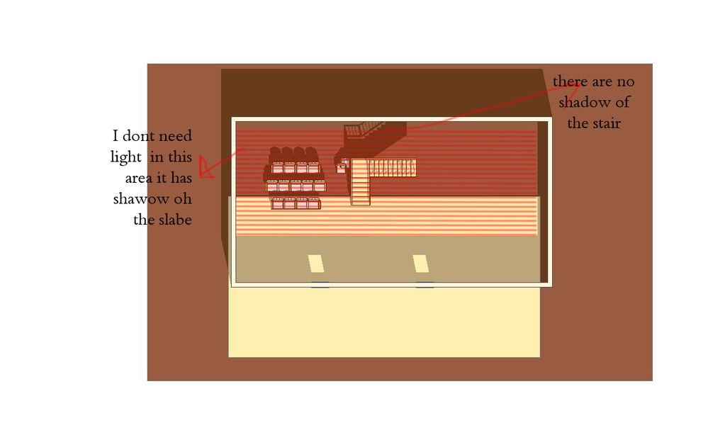

please can I put shadow on the floor plan as vidoe ( sun study) because when i do it in 3d view i should remove slape or roof ineed that with shadow of roof and vidoe becouse i know way to do that as pic (by copy shadow only form 3d view _top_ and past as fill)

I search not found any thing please like that pic

If I understand you correctly, the question you are asking is "How can I do a sun study of the floor plan, but with the roof still in position so you can see the shadows cast from it?"
Palawat gives a possible solution here.
To paraphrase - Set up a new lightworks material with the material's Colour Class set to Plain > pure black and set the Transparency Class to Plain > pure black also. Temporarily apply this material to the roof and any other structures you need to see through but still want to cast shadows.
Apparently there are some issues with multiple light sources, but give it a go anyway!
What's really needed is a true 'shadowcaster' material/shader. One that's completely transparent, yet still casts a solid shadow.
