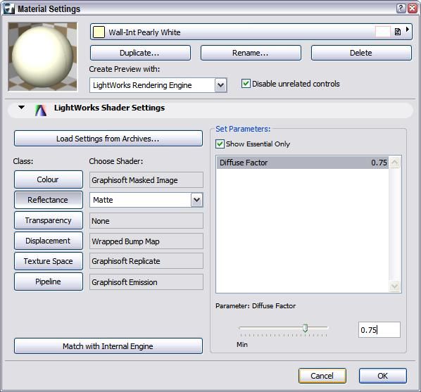

tigr wrote:
A tip of a day:
There is underestimated material setting called "Pipeline". When use carefully can be very helpful in getting white walls without crancking light up to the supernova bright value. Of course roughness is his friend.
Below are raw samples, no postwork.
Very nice and fine to see good quality out of ArchiCAD directly.
The lighting is rather soft and pleasing. Did you use Windowlights?
--- stefan boeykens --- bim-expert-architect-engineer-musician ---
Archicad29/Revit2026/Rhino8/Solibri/Zoom
MBP2023:14"M2MAX/Sequoia+Win11
Archicad-user since 1998
my Archicad Book
Could you please post the material settings?
Reflectance: Plastic
1.0
1.0
0.2
0.3
Colour: Pure white
Displacement: Rough
0.1
0.1
3
3
Pipeline:
Colour - 36,36,36
Attenuation - 0.0
To be honest I cannot tell for sure, it is an old project which has been modified since, but either it was combination of WindowsLights pointing up and down or LightCones pointing up and down. For interiors I found this solution to be most convincing and fast same time.
