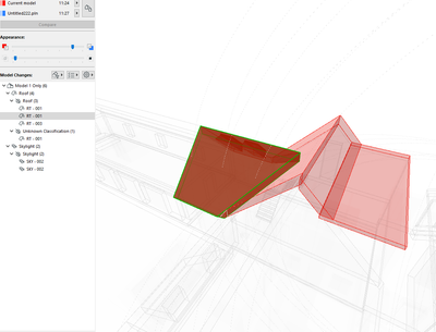

So apparently I've missed some other already implemented functionality that could be used to enhance element visibility control - Model Compare. It's actually ridiculous how much potential there is just sitting around. Without introducing any fundamentally new functions AC could become so much more efficient and intuitive when it comes to how we control element visibility.
So Model Compare gives the ability to:
  • Show elements based on criteria sets which are fine grained.
  • Selectable list of every element shown in the view.
  • Control opacity of the shown elements
  • Control how the degree to which the "hidden" elements are shown.
