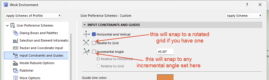

You can set your Work Environment settings to only allow for horizontal and vertical snaps.
Then the SHIFT key will only constrain horizontal and vertical.
It will ignore the rotated grid if you have set one and also not snap to any incremental angle.

Barry, yes, one can attempt to go this route, but it fundamentally doesn't solve the issue: speed, accuracy and above all, reliability  I'm no fan of Autodesk, but they got this right in the 90's (don't ask how I know.) That interaction was a simple hot key (defaulted as f8) that turned ortho snap on and off and it simply locked all tracking 90º and it was lightning quick.
Per your example, to do this in the current version of Archicad we first have to set it up in the workspace environment settings. Somewhat simple to implement this once, but then you are locked into this snapping paradigm and if you want to change it, you have to go back into the settings again, etc. Not a deal breaker, but not great either.
But here's the real problem: during a move/drag of an object one can still move the selected item(s) off the 90º axis even if the horizontal and vertical input constraint is checked. Yes, there's a 90º 'guide' that does come up, but if you move off that guide you then have to go move back on to it. If you have other snaps on that complicates things in that situation. Our experience is that the whole thing is wonky as opposed to precise. Yes, there's the  hold "shift" down bit. The hold "shift" down while moving works, but then if you let that go to "tab" into the tracker and enter distance information into the tracker, the ortho snap from the shift moves off that line/is lost. I do not understand why this interaction is helpful. Overall, the interaction is too much effort for something that should be incredibly simple. That's an interface design flaw from our perspective. Once you get into moving in 3D it gets worse.  There are many aspects of the software that far surpass other applications, but many of the fundamental user interactions in Archicad remain overly complicated or unreliable. This feature request is for one that seems a straightforward fix. So the request remains to Graphisoft to just make this simple, faster, and more reliable.
