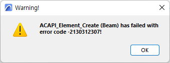

What error is -2130312307?
I added a menu in element_test and an error occurred, so I modified the existing menu, but the same error occurs.
This is the ac26 version.

Miha Nahtigal
Are you calling your create element function inside ACAPI_CallUndoableCommand block?

poco2013
Mentor
Archicad Error Codes
APIERR_NEEDSUNDOSCOPE -2130312307 8106038D The called command should be encapsulated in a ACAPI_CallUndoableCommand scope.

LeeJaeYoung
I found out about my problem and fixed it.
