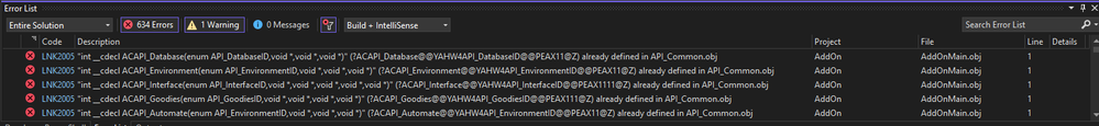

Does anyone know how to fix this? I tried to correct the path by removing Win but instead of fixing the error I got hundreds more.

RAFD
I already did that as I mentioned, here's the result after correcting the path

RAFD
Hi Akos,
I tried doing it but I got same 600 errors.
Akos Somorjai
I think the issue is not related to ACAP_STAT.lib then.
Could you please post the relevant part of your source, mainly AddOnMain.cpp/.hpp?

Akos Somorjai
I think the problem is that you are including ACAPI_MigrationHeader.hpp twice in your project, once in AddOnMain.cpp and once in APICommon.c – remove one of those where it's not needed.
That header includes implementations, so it should be included only once.
Best, Akos
RAFD
Thank you sir Akos, that fix almost all the errors now I'm down to 1
RAFD
I messed up. I got last 1 errors like I send recently after that I tried to clean then rebuild and the results got the 600+ errors back
