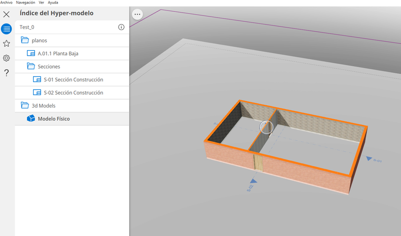

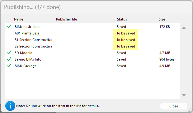

I've tried publishing several different projects in BIMx locally to a folder with a simple path, and I'm having the same problem with all of them: the plans aren't saved—only the 3D models.

Double click the yellow warning triangle to see what it says.
Don't use special characters in the file name - keep them simple - hyphens are OK but avoid periods.

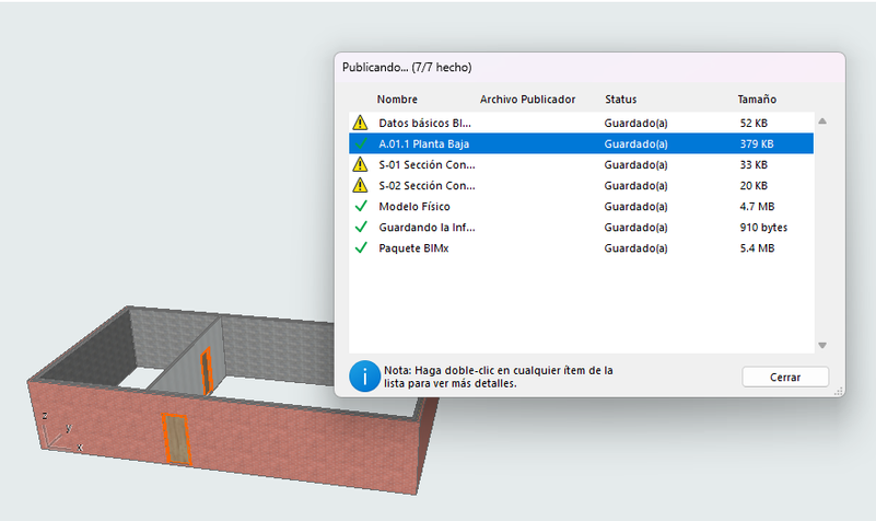

The yellow warning was because no preview image had been attached. Anyway, I've done that—I've even avoided using any special characters in the file names, plans, and views—but the problem still hasn't been resolved.

I have reinstalled AC29 with all the available updates, but the problem is still there.
But AC28 works great. 🤔

Open the PLA file, export to BIMx, and everything is correct. AC 29.2.1 SPA
The sections are not on a layout, which is why the hyperlinks do not work.

...I have just installed AC30 and opening the same file from the same computer and BIMx publishing works great.
I have no idea what is happening with my reinstalled version of AC29. 🙃
No solution, but anyway thank you all. 🤗
