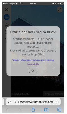

I use the latest version, the problem is not that the hyperlink cannot be generated, but its functioning. I'll give you an example, if I generate a hyperlink from the Web App of the  Bimx Demo Hyper-model
Web app:
https://bimx-webviewer.graphisoft.com/?modelId=0d020f3f-d95b-4941-8de1-0fd18b3bdf48&modelType=HyperM...
when I send the link to the phone and try to open it it goes to the browser and not to the installed app like the old version did.

Hyperlinks generated in the web app ("https://bimx.webviewer.graphisoft...") are for quickly checking the model in BIMx Web, which is optimized for desktop, and not supported on iOS since February. These links expire in 24h (see Help) to avoid overlap with model embedding. BIMx Mobile handles the "bimxapplication://..." custom URL scheme from outside the app, and never supported the "https://bimx-webviewer.graph..." generated in BIMx Web.
