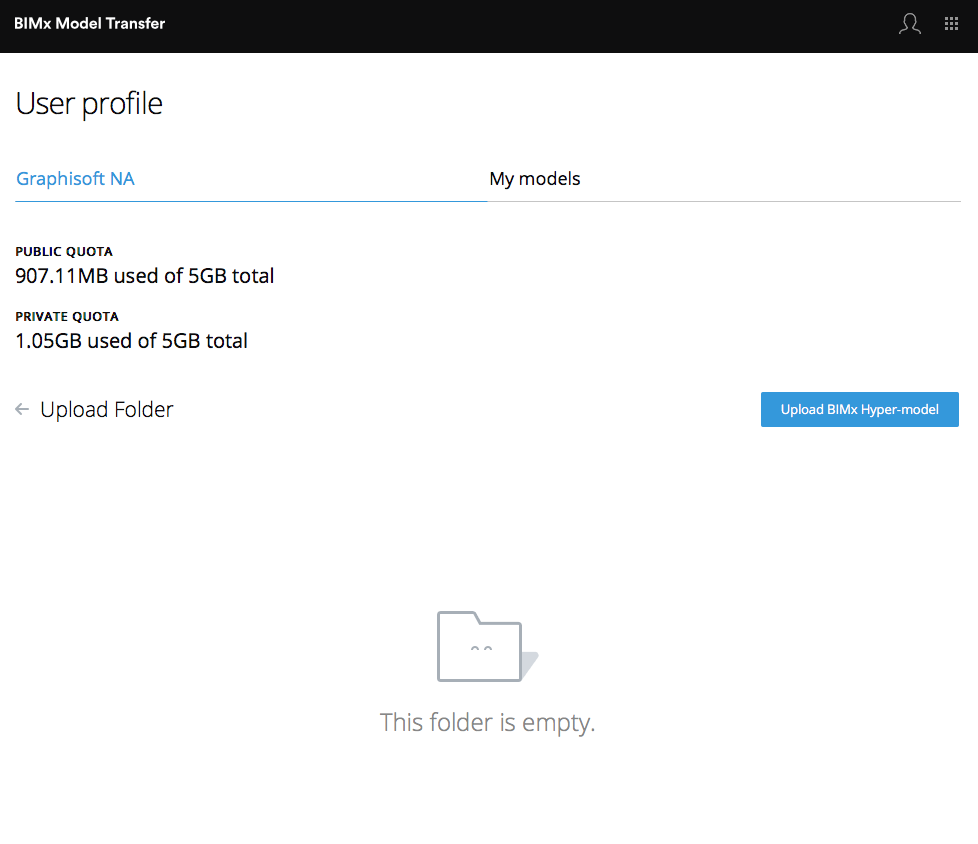

5. Login to the BIMx Transfer site and create a new folder to place your BIMx Hyper-model in.
6. Click on the newly created folder to open it up.
7. Drag the BIMx Hyper-model onto the folder icon to upload it.

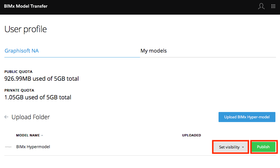

8. Once the file has finished uploading it will begin processing.
9. Once the processing has finished, set the model visibility to either public or private and click Publish
