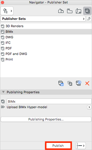

1. Select the BIMx Hyper-model publisher set in the navigator and click on the Publishing Properties... button.

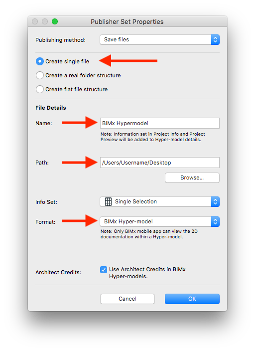

2. In the Publisher Set Properties dialogue box do the following:
• Set the Publishing Method to Save files
• Set to Create single file
• Name the project
• Set the file path
• Set the Format to BIMx Hyper-model
• Click OK
3. Click publish in the navigator.

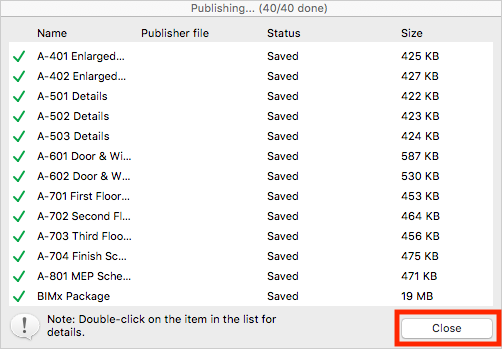

4. Once the Publishing... dialogue box has finished, click Close.
