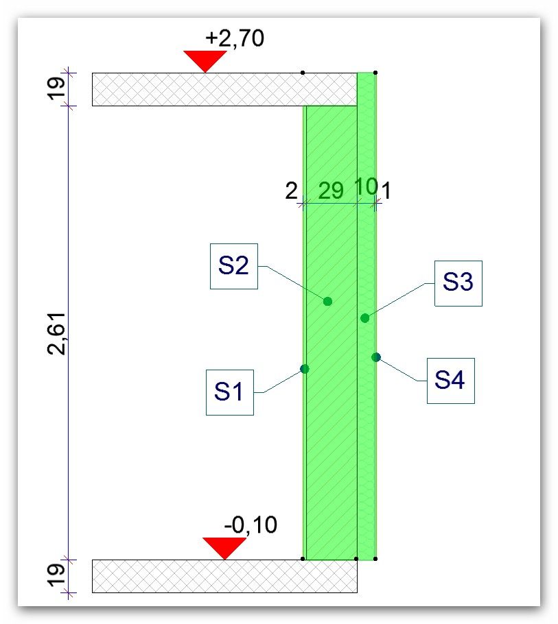

If you use composite walls with insulation skin that goes on top of the slab (see the image), you must add some correctional factors to the volume calculations. In this case: Skin 1...V1=V1/1,03; Skin 2...V2=V2/1,03; Skin 3...V3=V3×1,06; Skin 4...V4=V4×1,04.
