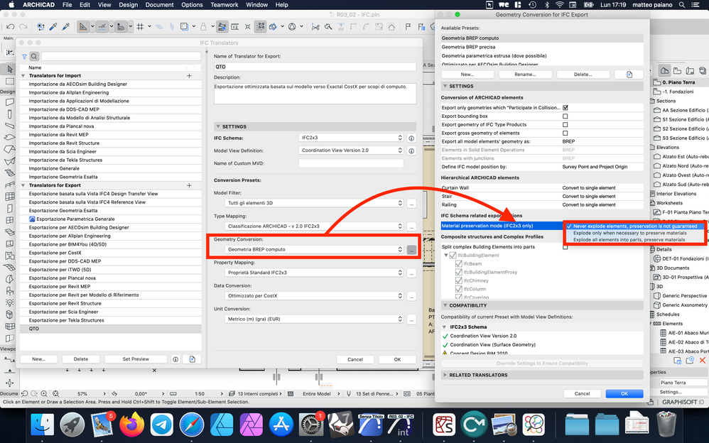

I don't know if it's exactly what you were looking for, but from AC25 update 2 you can export the Wall with all the components information called with the name of the Building Material:
so we don't need to explode skin components anymore to understand the name of the Material and all the rest of the related info!
I hope this may help!

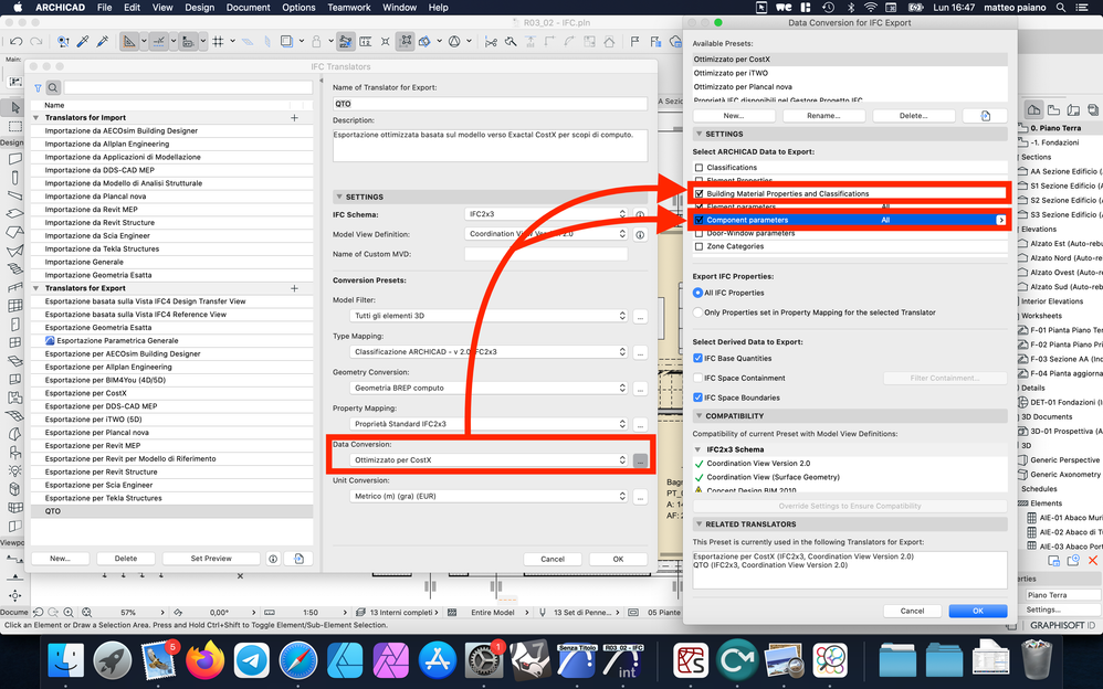

Talking about export settings I just set geometry conversion to never explode elements and in the Data Conversion I choose what I want to export, eg. Components Properties and Materials properties (I attached a couple of screenshot).
I hope this may be helpful!

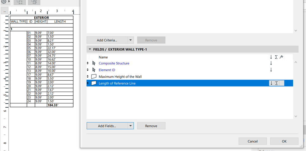

But you can Schedule the Length of the Reverence lines and some other Wall Length fields - if that is any help. I seem to remember using Length in 3D or something like that too. ?

Indeed @Steve Jepson , you can schedule the length of the reference line.
But the given length is identical for each of the skins as there is only one reference line for anyone composite/complex profile, regardless of how many skins it has.
And for this to work we need the length of each of the skins, taking into account that wherever skins touch/intersect, the common area of these components are calculated only once.
I just can't seem to grasp why an export to IFC has no length attribute included?!

If the length of the wall is enough for the QTO it's possible to export it (and a lot of other info) by checking the "Element Properties" in the Data Conversion settings.
