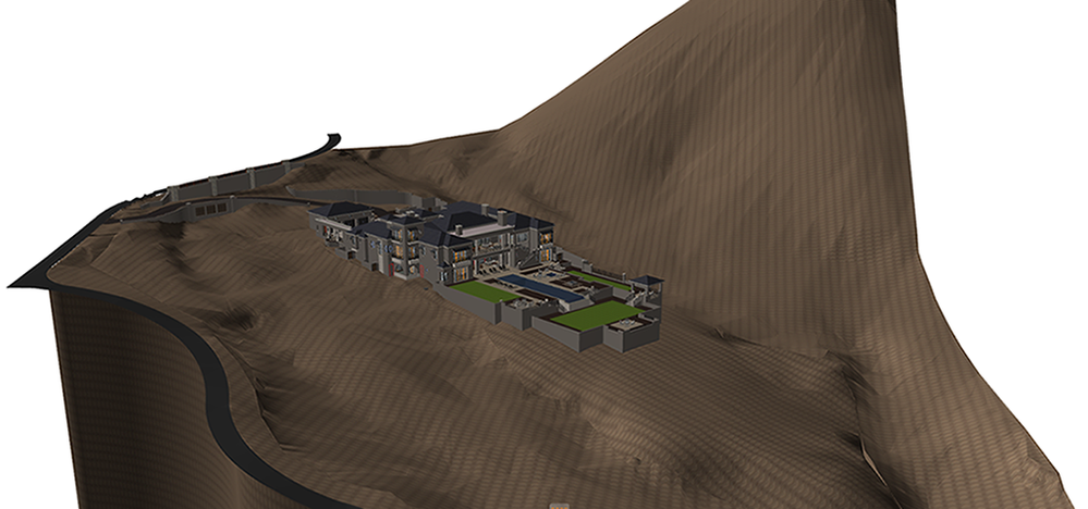

We draw all of our sites 100% in 3D using the topo from our Civil consultants. I have never tried a point cloud or importing the civil points directly.
We find that if we magic wand the civil topo lines ArchiCAD has trouble because there is to much info.
We "trace"/redraw over the civil topo with less points and this allow us to have a workable 3D mesh. We can then establish Top of Walls etc which are very accurate for our building team.

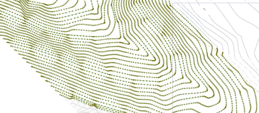

rgarand
The magic wand tool works as intended and makes things very easy...although it picks up too many points along the polyline and adds lots of info to the mesh. We find the meshes become hard to manipulate the more points a mesh has.
The sites I deal with are not overly large...6-10 acres but the meshes become very hard to manipulate if they have too many points at this size.
You can set the spacing of the points you want the magic wand to create. If you are getting too many points, adjust the settings for a wider spacing or larger deviation. Take a few minutes to read the reference manual and try out some different options.
EDIT: Another technique you can try is using "Best Match" and converting polylines into a spline. Then, switch back to "Linear Segments" and set the spacing to something appropriate and magic wand a polyline elevation onto the spline. You can get 4 points/contour line if you want.

rgarand
I have read the manual for the magic wand and I have played with the settings...
The files we get from our civil engineers, which are probably pretty standard, have many segments along the polylines (see attached for the number of points). The settings within the magic wand do not have any effect when I change them. The only way they would have an effect is if I decreased these settings, which would be counter productive because I am trying to decrease the number of points along these lines.
...please do not assume all of us here jump on the forum without doing proper research and troubleshooting.

Please see my "EDIT" above.
