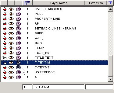

I'm new to all this - a student learning on his own. I'm using v8.1 and a friend has given me a .dwg site plan file to use for experimentation.
The survey was given to my friend by a surveyor and he then used AutoCAD to continue onwards from there.
I am perhaps laboring under a naieve assumption that .dwg files contain layers and that it is possible, upon import into AC to have the layers separated.
I'd like to be able to delete some existing labels on the plan and substitute labels which are more descriptive, but I can't separate the survey layer from my friend's work (the comment I want to change are on this layer).
Could someone please point me to a reference on this or possibly explain where my thinking is incorrect and what I have to do to overcome this difficulty?
Thanks.

Yes, I'm using the student version of v8.1.
I thought the restriction was on export, not import.
I have done Options-->Layers-->Show All Layers but perhaps my navigation knowledge in AC is lacking.....I can't find a way to access the layer.
I've been using the Quick Layers pallette to try and access the text layer. Maybe that's not the way to do it.

If you hit crtl+L you will get you layer list up. You can see a list of all layers used in the DWG file.

Ben,
Thanks for the tip....I guess that's what happens when you buy a .edu version.....no manuals to read through while on the bus😞
Is there any way of knowing which layer text or other objects are on when looking at the combined view on-screen? I have not yet found a way (eg. right-click on an object) and have a properties box open to tell me which layer something is on.
When I did Ctrl-L on the file I have, I can see about 45 layers listed, some of which I show in the screen shot below - given the naming conventions or lack thereof, I'm just guessing at which layer the text I want to modify is on.
Thanks
Alan

Is there any way of knowing which layer text or other objects are on when looking at the combined view on-screen? I have not yet found a way (eg. right-click on an object) and have a properties box open to tell me which layer something is on.Make sure you have your info box open (window menu / palette display / show info box). It sounds as if you should go through the tutorial and get some of the basic understanding of how the program works.

Beginner wrote:If anything is selected, you see the layer it is on in the Info box (top of your screen, below the toolbar).
You can also hit CTRL T to get to the tool settings; the layer in on the bottom.
The manual is on your installation CD, in PDF; if you have a laptop, you can read it on the bus, or print it out ... go through the tutorials, as not knowing the basics will just produce frustration ...
