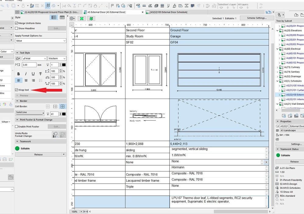

Ben-Abo
Hi, I found the solution, if still anyone looking for it.
Just tick Wrap text, in Text style.
