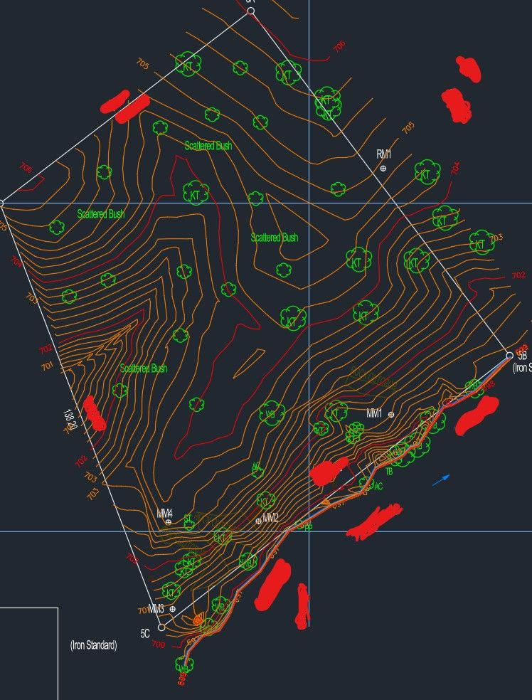

I am trying to create an automatic mesh from a DWG file.
The DWG have contour lines with Z Values to each node/point on the lines. Is there anyway to create a mesh from these files?

You need the X, Y & Z co-ordinates, which I believe you can get from the DWG file (not that I have tried, but I recall reading about it in another post).
You can then use the option to 'Place mesh from surveys data' to create a mesh from the text file containing the co-ordinates.
But the mesh will not automatically generate contour lines.

That's exactly what I'm looking for... How to create the .txt or .xyz files from the autocad file...

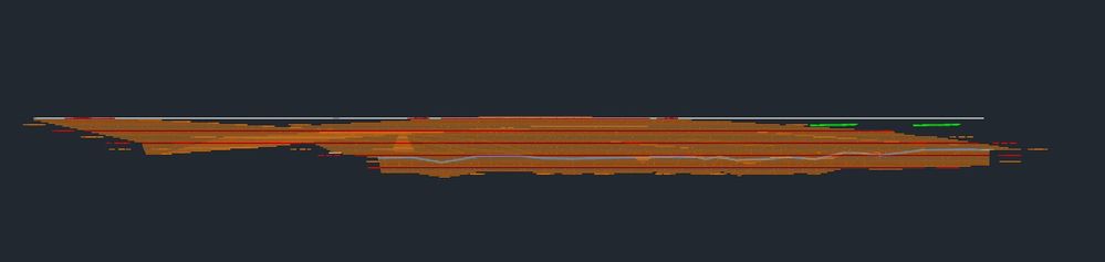

There is a way to create points from lines in Autocad, but it's the same manual input you would need from Archicad...
You have to select each line seperately and do a point exercise. I couldn't find a way to select all the lines and create points on all at the same time.
