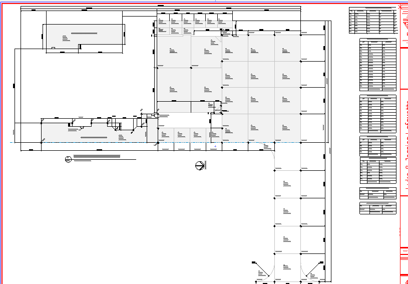

Also, I a need to use something that the Level Dimension Tool can be used with because I am placing an elevation markers on the slabs (roofs) is looks something like this

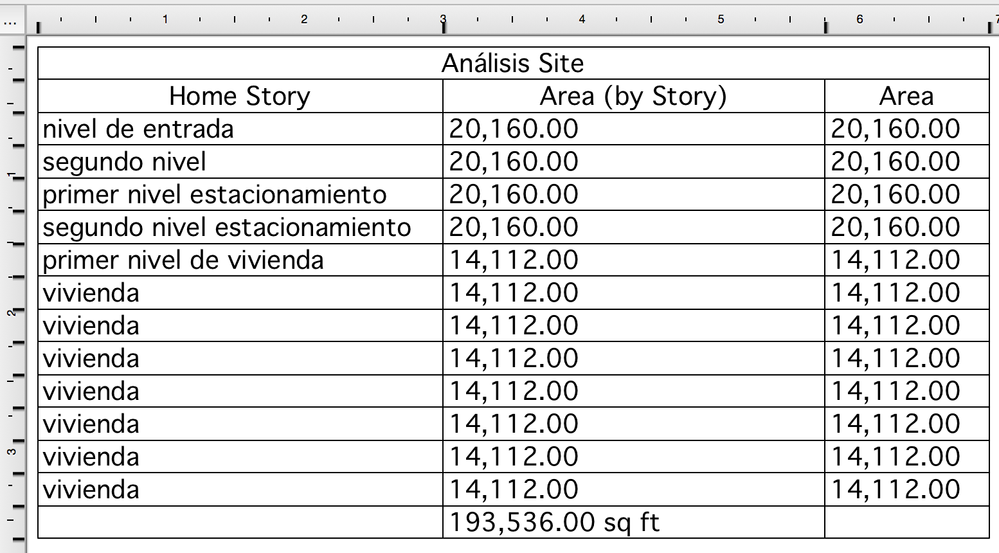

"Area by Story" or area should do it?

Eduardo Rolon
Area from this model.

I don't see any areas for the morphs shown in a schedule.
I don't think it works.
Eduardo Rolon
mine does. so it must be something else
