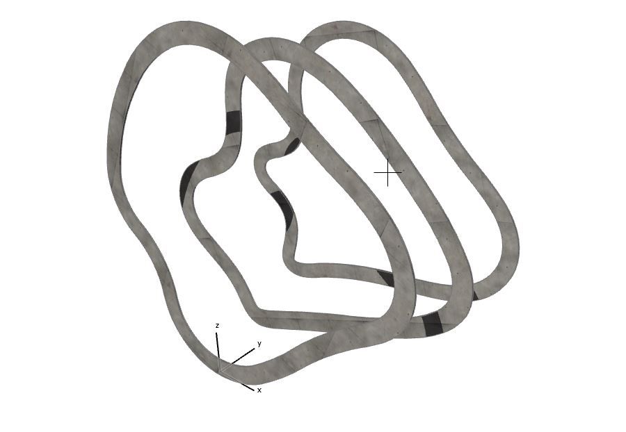

I am working with a point cloud (imported from a .e57-file), which among other things, contains a tunnel.
The tunnel is of varying width and height over the run of its length.
What would be the best practice to make this tunnel into a complex profile, object or similar?
What I would like to do is take section-snapshots every meter or so and then have a surface extrapolated between those sections.
Is there a simple way of achieving this that I am missing?

I would probably used Rules Shells for these 1 meter segments because it can model the geometry and its thickness is constant.
A few clips of the Ruled Shell:

You know, I can imagine the Rhino-Grasshopper-ARCHICAD Connection would be ideal to do this. Although I don't know if Rhino support Point Clouds or not. But in Rhino it would be very easy to trace the contour at each 1 meter interval, then generate a NURBS surface based on them, and then use Grasshopper to generate the Ruled Shells in ARCHICAD.
Just a thought, I have not tested it myself.

The clips are good, but I realize now that I was a bit short on information in my post, and I hadn't really formulated the problem for myself either.
The tunnel is a few km long so I need to write some kind of macro that will follow a 2D-path (center of tunnel) and then every meter make a section perpendicular to the path in order to get the shapes in the image in the previous post. Once I have those section-shapes perhaps the Shell tool is the right approach.
Is is possible to write such a macro in Archicad? Or am I looking at some external software? I will definetely look into what Rhino is capable of - thanks for the tip!

He is a clip I found in which in Rhino you can convert a Point Cloud into a Mesh. You could do that with your tunnel. Then you would only have to slice that tunnel mesh with planes at 1 meter intervals and you would have the section profiles. I am not sure what stage is the Grasshopper-ARCHICAD connection but from those section profile polygons you then may be able to create the Rules Shells. Or maybe you should create Morphs from them.

I've been working with the cloud and come to the conclusion that it is too big to do anything manual. One of the problems with the cloud is that when you take a section through the tunnel you won't get the tunnel shape complete since there are installations (pipes etc) that have been blocking the scanner. I've looked at using Matlab to get a spline to do a best fit of the points in the section and thus getting past the "missing" pieces. It isn't that hard to acheive, however doing an itteration, by following a 2D-path in the center of the tunnel, to have it produce thousands of section-splines is beyond my knowledge.
I have also stumbled across a 3rd-party software called 3DReshaper that - at least according to the specs seems to do what I am after. I have downloaded the trial version, but have yet to test it.
