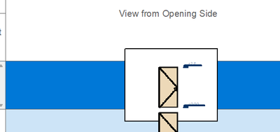

I'm looking for a way to make my drawings fit the chosen cell they're on, that way I may detail them as much as I want without infringing on the schedule's clarity.
If there's a better parameter for this than the "View from Opening Side" one then let me know, I'm new to archicad schedules. I just need my classifications to be linked to a detailed drawn sheet showing all the details of the door. Using Archicad 22.

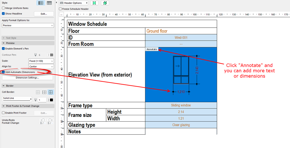

I'm looking for a way that improves the linking between schedule and technical drawings, something that would automatically generate the autotext for each drawing I generate.
Schedules only show a preview image of the door or window element, not any of the documentation from your drawings.
You can automatically add dimensions or you can add extra annotation yourself.
