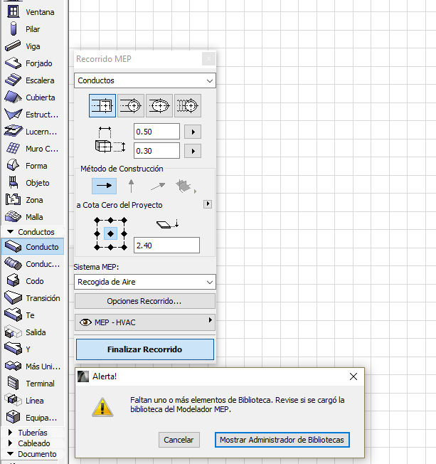

The MEP modeler library is not instaled
I installed the MEP Modeler i set the profile to MEP, and i can see all the toolbars but when i try to start something it says chek if the MEP library was loaded.
2 REPLIES 2
Probably, you forgot to load this library and you should do it. This one stays in root ArchiCAD folder, near main ArchiCAD library.
Vincent G_
Legend! thanks, @Anonymous, I was looking all over the internet, Reddit, everywhere and finally found the solution here, and it's simple asf.
