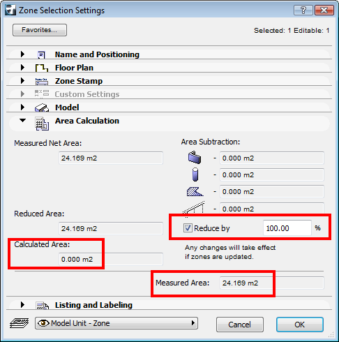

You can subtract 100% of the Zone's area in the Zone Settings Dialog.
This way the calculated area of the Zone will be zero.
But even in this case the Balcony will be listed, only it will be listed with zero area.

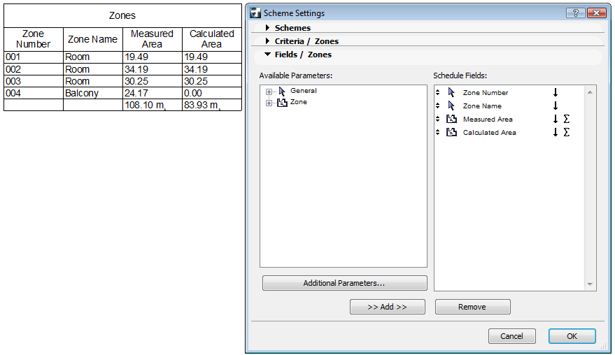

Hi Bartek,
Yes, I think the case here is that it is not possible not to include them in the total if they are listed.
What I can think of is this:
There is something called Measured Area and another thing called Calculated Area, among the listable parameters.
Maybe you should do the subtracting I told you about for the balconies and list both. The measured area will list the full area the calculated area should list zero m2. Then you will have the data you need in one of the columns.
Here is the Area setting for the Balcony Zones.
Hi Laszlo!
Thank you again for fast reaction:)
@Mesured and Calculated areas of Zones
- yes, I considered solving this issue that way before, but I was looking rather for some kind of trick or something that would meet all my requirements 😜
