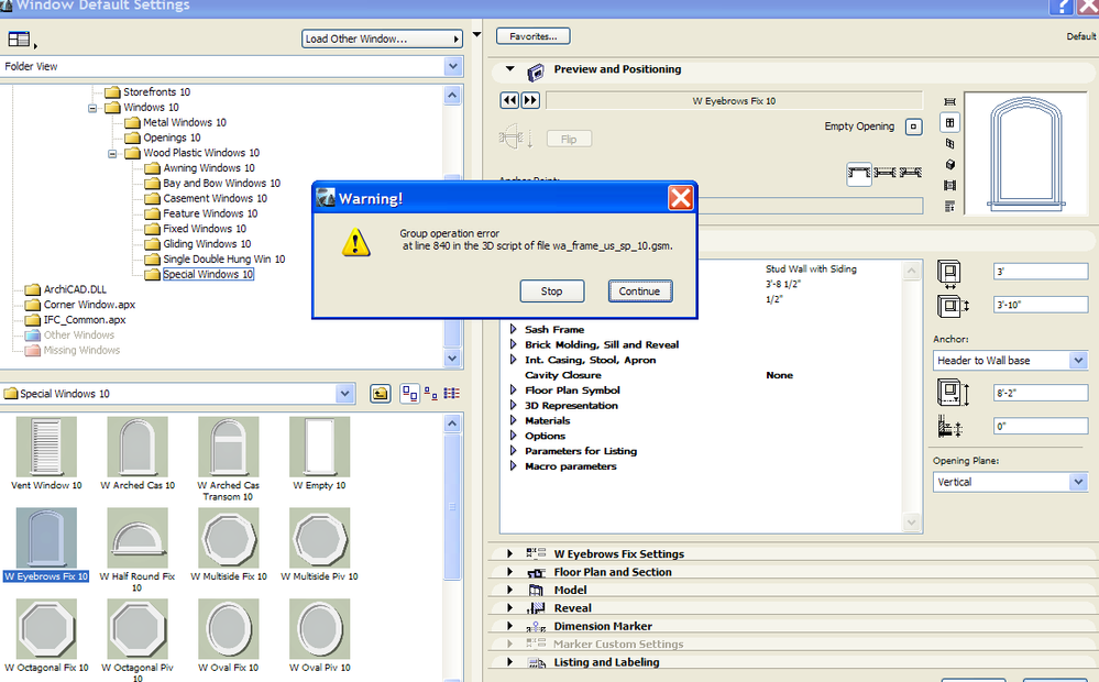

I'm not having much trouble with just single doors or windows. I have trouble ganging them together. I wanted to put this 1/2 rnd on top of this triple window when I gang them together the trim is removed to do it, but how do I get the trim to be above the part without the 1/2 rnd ? I thought I should gang the 3 windows together and not use the pre made one then just put the 1/2 rnd above the center one but I got error messages. Another thing I wanted to do was make an eyebrow window this size I was able to change the width but when I changed the height got another error message (second screen shot). I was also wondering how to do a cased opening and garage doors with the top corners angled.

Here is the other screen shot
Did anyone ever resolve the error in line 840? I am attempting a similar eyebrow window but run into the same wall as BAS. I need it to be 5' wide and 14.625" tall.
