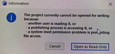

just tried this and here is the message I got...
It looks like the computer things that the file is currently open?
