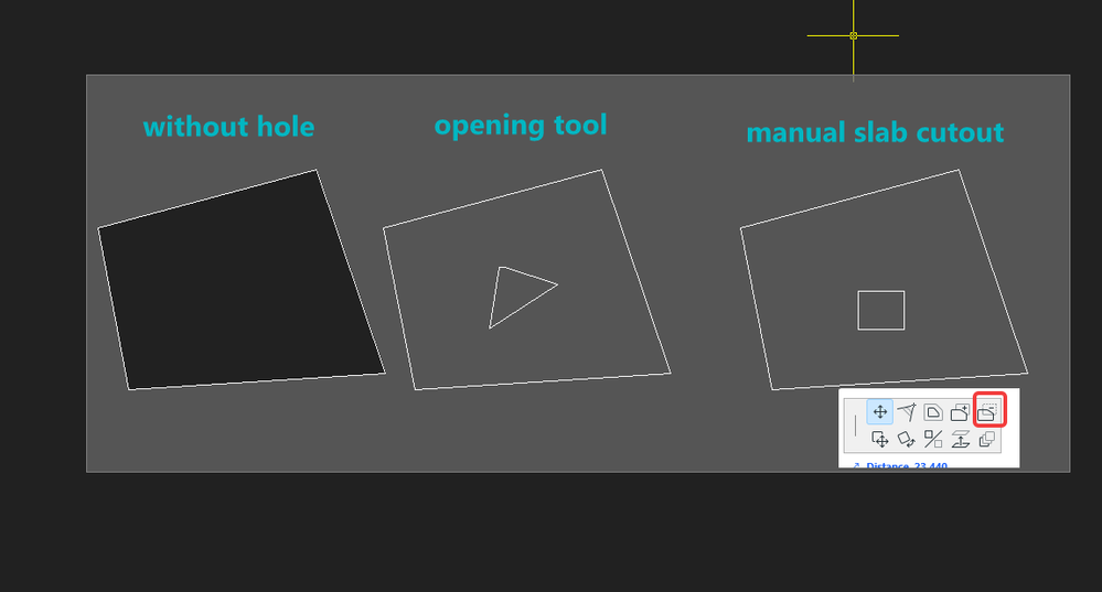

What about slabs with holes? In this case wipeouts are not produced, and doesn't produce any other fill either. It looks like wipeouts do not recognise "islands" in the way hatches do.
Do you have any suggestion so that export to dwg looks more like the drawing from AC?

What kind of holes? Manualy made poligonal holes?
Have you tried the Opening Tool? I'm refering to the one added in AC23, not the window or the door.

I tried both ways: opening tool or manual cutout, and it doesn't work either way. UjIzg2j7ny.png
