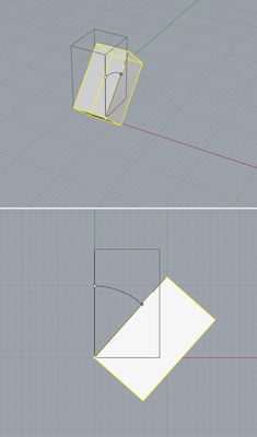

helloo, thank you so much!!! do you maybe know how i can tilt the object in rhino?
Nurbs
Use the "Rotate" command. Select the object and define the rotation in the corresponding view (the axis you want to rotate the object to).
AC16 - AC29, Rhino 5-8. Alienware WIN 11
After you import a Rhino file into Archicad, you can select it and convert it to Morph. Then you will be able to easily manipulate the Morph geometry: you will be able to both resize it in all direction and rotate it as well.
