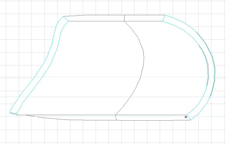

When I send my volumes from Archicad to cinema, everything is ok. When I come back to Archicad I see in my volume all the triangulate sides like in the picture. It is the same in cinema 10 and 11. It didn't happen in archicad 11 and old add on.
Everything in cinema is set correctly (smooth etc.). I repeat: the same operation works properly in archicad 11 and old addon hidding the sides properly.

Hello, I know its an old topic but i am having the same problems here. And i use AC13 and C4D 11.5. THe Exchange plugin triangulates the models wich is a shame. On the opposite, the 3DS import plugin has the "force smooth" options and it works great but does`nt have the cutplane sensitivity. What can we do to have the best from those 2 plugins?
Did anybody wrote to Graphisoft about the future realse of the C4D exchange plugin? I am sure this improvement is very easy to do.

Graphisoft guys are too lazy to write working plugin.
You can use 3ds for cross-section and obj from c4d plugin for floor- cut plane (next explode geometry to lines and MANUALY (DAMNNNN this can be painful) earse the triangulation)
The other solution is switch to Rhino! curently on Mac is open via invitations WIP wersion ---> which has beautiful working commnad MAKE2d

Thanks Mikoaj for your advice. Can you be more specific? I have imported an organic model with 3ds in plugin and in cross-section the fill cut surfaces doesn`t work. Only the cutlines are detectable.
And about the obj method : How can Archicad import obj files and how can i explode them ?
Thanks again !
