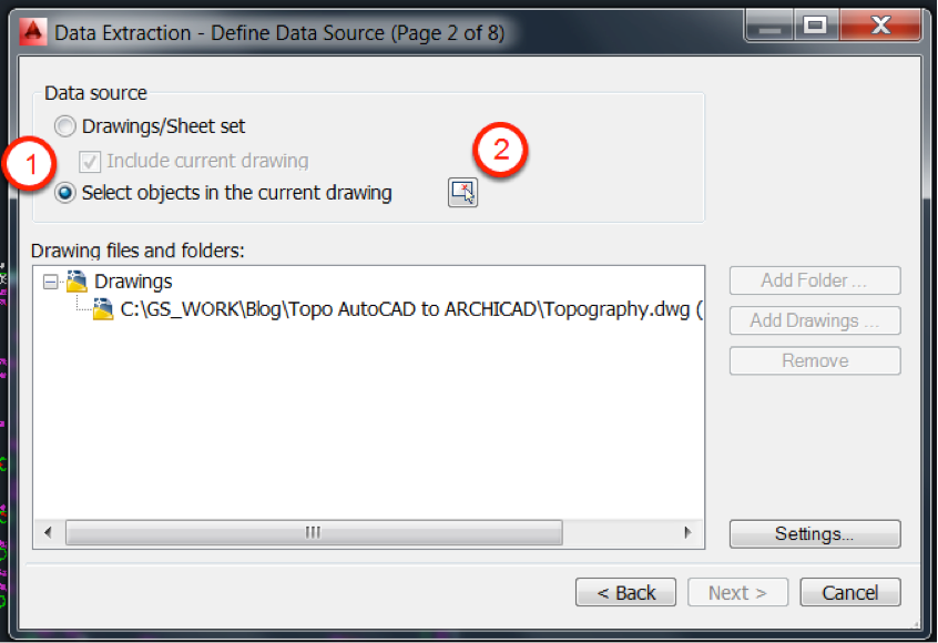

  1. Choose Select objects in the current drawing and
  2. Click on the button next to it to select the objects (blocks)
Select everything using the window selection and press Enter

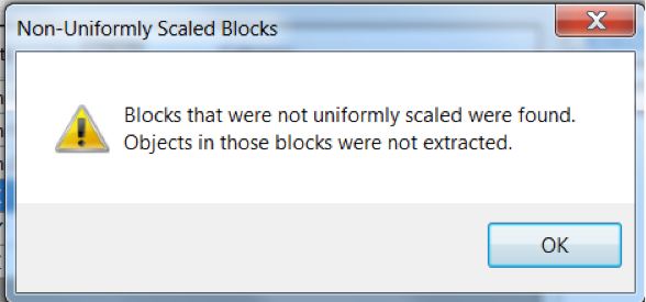

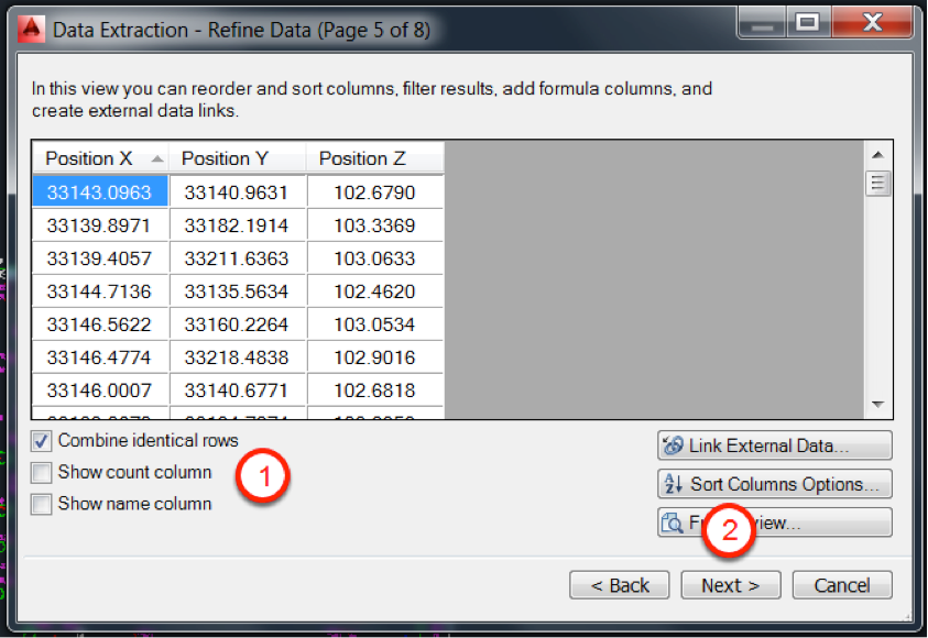

If you get the following error message please check and correct those affected blocks.
  1. Uncheck Show count column and Show name column as we do not need them and
  2. Click Next >

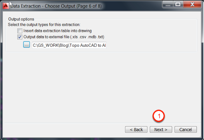

  1. Choose Output data to external file (.xls .csv .mdb .txt) and
  2. Click on the button in front of the file name text filled
  1. Give a name
  2. Choose the file type as *.txt and
  3. Click Save
  1. Click Next >
  1. Click Finish to complete the extraction.

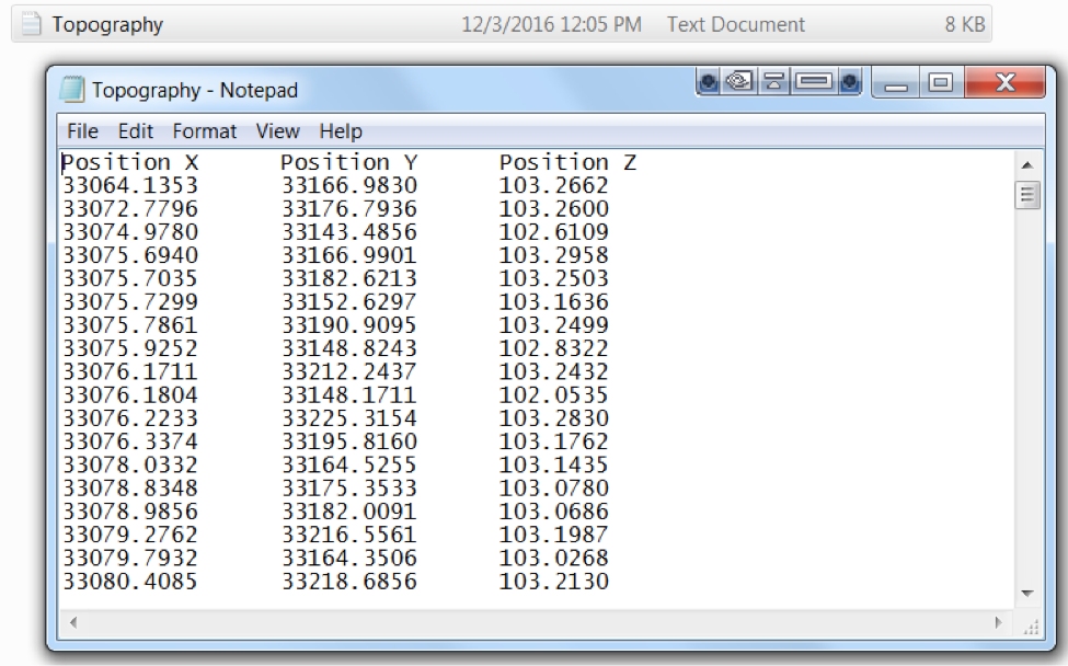

The text file is shown below, now we are ready to import this data into Archicad.

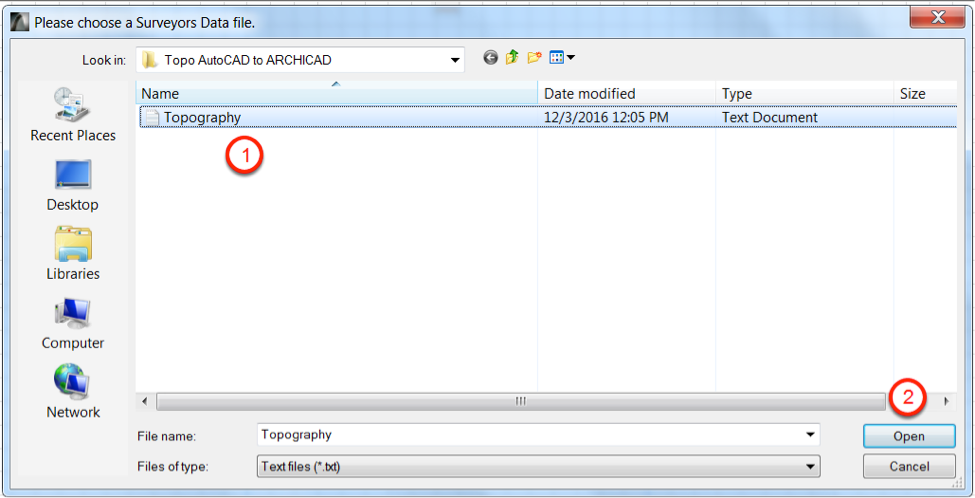

Importing Data into Archicad
  1. Go to the menu File/Interoperability and
  2. Choose Place Mesh from Surveyors Data…
  1. Choose the file and
  2. Click Open

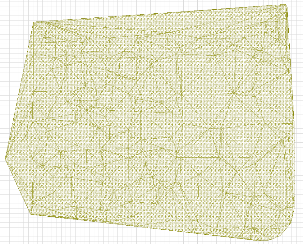

Mesh will be created based on the point data from the selected file as shown below

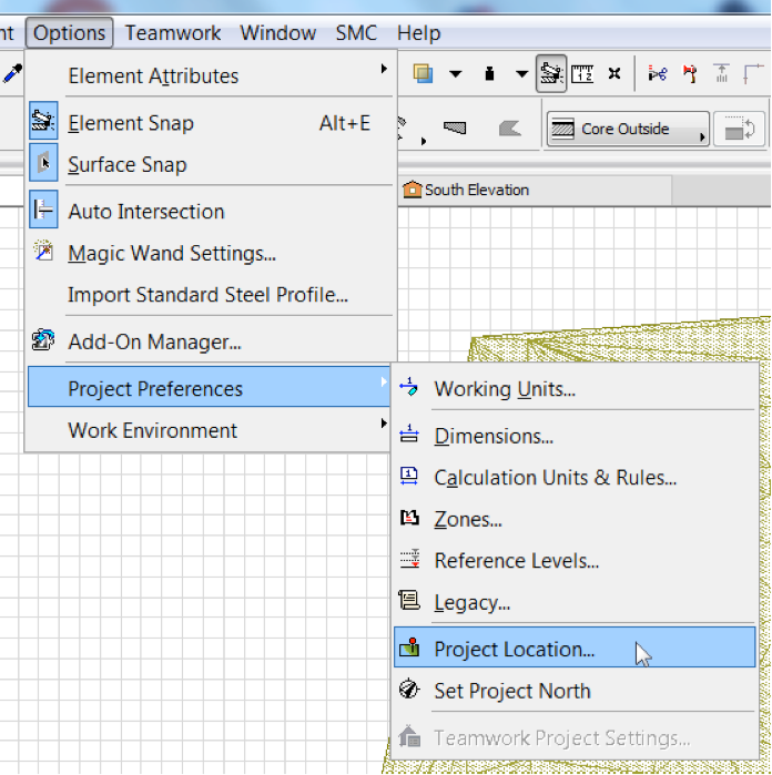

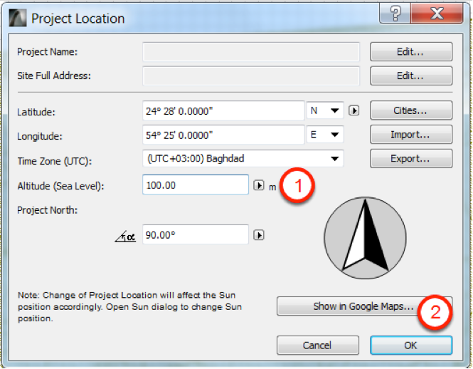

Go to the menu Options > Project Preferences > Project Location… to set the sea level.
  1. Enter 100.00 for Altitude (Sea Level): and
  2. Click OK

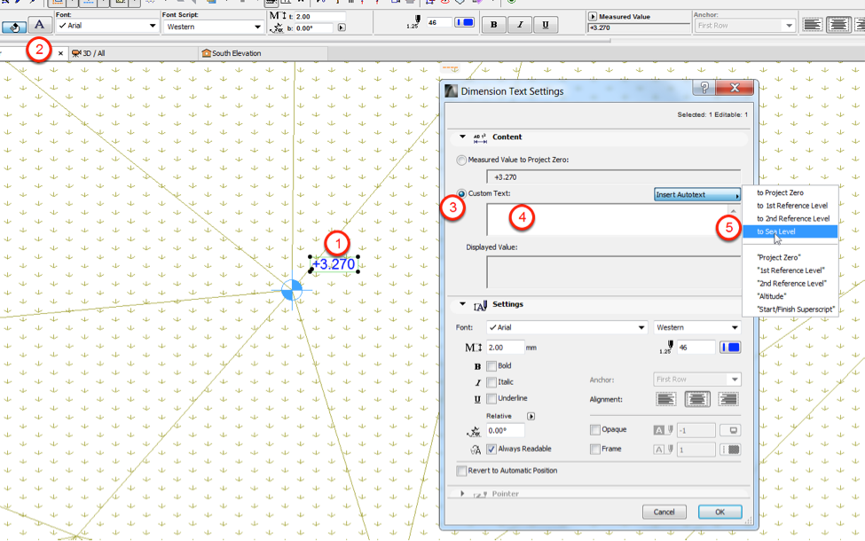

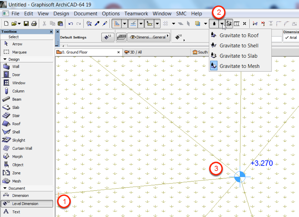

  1. Choose Document > Level Dimension from the Toolbox
  2. Choose Gravitate to Mesh from the toolbar
  3. Place on the level dimension on ridge (contour) intersection of the mesh as shown below
  1. Select the text
  2. Click on the Settings Dialog button
  3. Choose Custom Text
  4. Remove the existing value

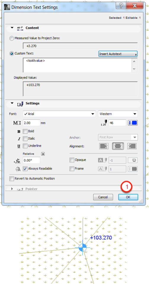

  5. Insert Autotext as to Sea Level
  1. Click OK. The value will be shown from the sea level and it will be easier to verify now.

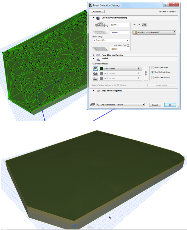

Go to 3D view and open Mesh Selection Settings. Choose User Defined Sharp to make the mesh smoother.
