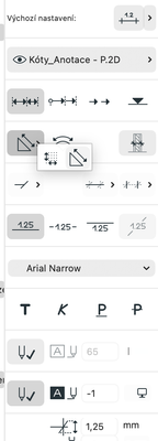

Maybe someone accidentaly switched geometry method (default shortcut was "g")?
It should be the one on the right (You can find this settings in info pallete when dimension tool is active)
