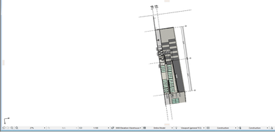

AC25 INT, new variation of the same issue: in this file there is no rotated plan.
An elevation marker drawn in plan at 45° (the FRENTE OCHAVA in the picture) [Edit: the marker was created by duplicating and rotating some other orthogonal section marker; wonder if that may be related] produces an elevation all right.
I trace-reference that elevation, and get what the picture shows.
The trace has not been accidentally rotated, it stays there when resetting the trace position. Tracing the view and the elevation viewpoint produces the same result.Screen Shot 2022-09-21 at 21.22.33.png
