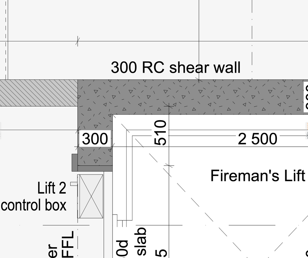

AC 14 Dimension opaque owerlaps the line. Help
I used the "dimension opaque" in AC 13, but in new version there is a problem. The text opaque covers the line.
Can I adjust the distance or opaque offset ?
In Layout it looks like the line was broken.

I just tried with Arial as the text.
It seems the smaller the text size the more it overlaps the line.
Definitely different in 13.
There the box around the text rescales proportionally with the text.
In 14 it remains a set distance around the text regardless of the font size.

Can you show an image of the problem you are having?
Hello Barry,
Attached an image as an example (but it really happens a lot).
My text is Arial, size 2mm.

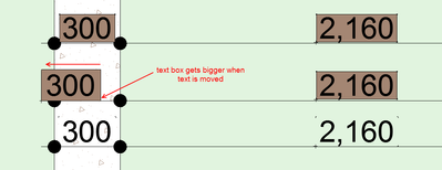

This happens when you move the text, usually.
If you revert the text back to the default position, the bounding box around it shrinks.

Ah, I see the problem.
I have never noticed it before, but I rarely need fills behind my text.
As soon as you move the text, the surrounding frame/fill increases in size.
I have no idea why it would need to do this - I say bug.
I have no solution other than to move your text slightly away from the dimension line rather than just horizontally.
In this case the Arial 2mm text is fine in the default location - fits inside the dimension lines just fine.
I had no need to move the '300' text at a scale of 1:50.
If you find this is not the case with you then maybe look at the placement method you are using for the dimensions.
