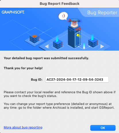

When trying to publish a set, Archicad crashes immediately!
I cannot publish the files no matter what.
Initially I thought the problem was due to broken permissions on the folder that was on the server. I fixed permissions, but AC kept crashing.
I saved the TW file as pln, and did an "open and repair" still nothing.
I tried changing the path to local folder on my computer, or publish just a single Layout instead of the entire transmittal, still nothing.
The moment I click the Publish button, AC crashes
Help, I need to send the layouts, I have sent several bug reports to Graphisoft
Operating system used: Mac Apple Silicon 13 Ventura
Solved! Go to Solution.

I assume you have updated Archicad 27 to 27.2.0, the latest version? Not that I think it'll make a difference but worth a try.
2024-04-17 02:52 PM
Are you trying to publish DWGs with the option selected to combine in to one document? There used to be a bug that caused this which was fixed.
2024-04-17 02:54 PM
No, just single PDF's
2024-04-17 02:57 PM - edited 2024-04-22 02:15 PM
2024-04-17 03:01 PM
Do the drawing names/numbers have a commonality amongst them all? Is there a special character that appears in all of the layout names/numbers? This can sometimes cause a crash when publishing. When you have tried publishing a single layout to PDF, have you always tried the same one or the first one in the list?
I'd check the names for special characters.
2024-04-17 03:29 PM
Im using AC build 4060, so the previous version.
I rename the Layouts with the Revsion ID and and the Folder name
I made a new publisher set, which lets me publish single Layouts, and started publishing
I noticed that the crashing now happens to a specific folder which has relativelly long file names, so maybe that is the problem
2024-04-17 08:13 PM - edited 2024-04-17 08:13 PM
It could be the length of the file name. Can you upload a screenshot of the folder structure and names of the drawings you are trying to publish?
2024-04-18 09:46 AM - edited 2024-04-18 09:57 AM
It was the length of the file name.
I updated to build 5003 and the problem got solved.
