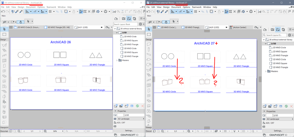

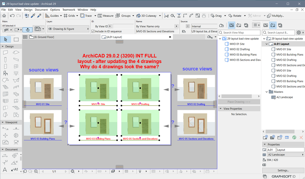

These four drawings are linked to four views.
Each view has different MVO settings for windows and doors.
After updating these four drawings (either together or separately), they display inconsistently with the source views.
I tested this example in ArchiCAD 27-29 and unfortunately encountered the same error .
However, everything works correctly in ArchiCAD 26.
What is the problem?
Can someone take a look at the attached PLN source file (Ac29 int) / zip.
What is the problem? Is this just me? Are there any environment settings or other issues?

1. @Patrick M, as I wrote before, to be sure that something is wrong, I finally used the standard template; in the case of Ac29, only the original libpacks (without any custom libraries) - a pure Ac29 project!
2. @Laszlo Nagy, ok, I'll report it to my local Archicad reseller
Edit
It couldn't be simpler!
I've attached the Ac26 project without external libraries (no doors/windows, etc.). It only contains an internal library with two simple objects, slightly modified to be 2D and 3D.
(downloaded from https://gdl.graphisoft.com/tips-and-tricks/custom-made-model-view-options-object/)
This confirms that, starting with Ac27+, there's a problem with correctly using MVO settings for 3D views inserted into the layout. 

I've just seen this post and easily recreated this bug in AC28 INT 28.4.0 (7002) on Windows 10.
New file, default INT template, default settings. Just created 3 basic views with different MVOs. All views are set with "Auto Update".
It's weird that Archicad simply keeps the last updated 3D window and uses it whenever you update a 3D view placed on a layout.
It's not just inside Archicad, it's goes through when you export a pdf as well.

Tested this with Archicad 29.1 4006.
I can confirm this behaviour. I haven't realized this till now because I almost never put 3ds as layouts.
