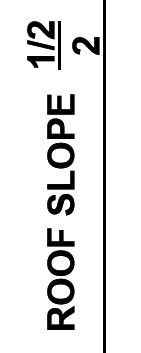

Attached is a screenshot showing a fraction that I "constructed" using several texts. How can I add a fraction in using the text tool?

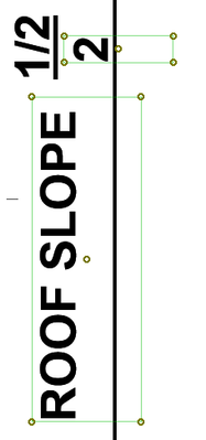

Thank you, Barry. Is there an ASCII code that helps with roof pitches? As you can see in the below copied screenshot, I used three text boxes to indicate the roof pitch (0.5/12). I have a fraction (1/2) in the nominator!

There are only those 3 ASCII codes that I know of.
It just means you can type ½ as one character instead of 1/2.
So the best you could do is ½/12
To have the text vertically above and below as you have shown, you will need two separate text boxes or one text box with a carriage return (enter) and set the top line with underscore style maybe?

FYI:
You can create a fraction in Unicode by using a superscript code + fraction slash (U + 2014) + subscript.
Or you could just use a fraction generator site as in:
