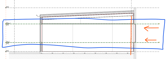

screenshots below:

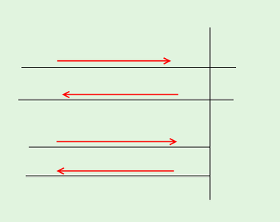

first one shows the 2 polylines i want to adjust/shorten towards the orange line. from the right-hand node towards the orange line, specifically.

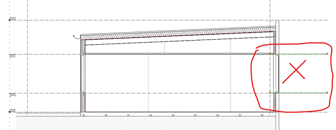

however in the second screenshot, it adjusts it from the LEFT hand size, where i don't want it to because I have my elevation dims here. I always thought it prioritises to keep the longer side & adjust the shorter one from where the adjustment line is drawn/clicked.
I don't want to do a Marquee adjustment, because i have other lines nearby that i don't want adjusted & having to drawing a marquee around these unaffected lines & to try & intersect the ones i want to change seems to have too many clicks to it. I could simply adjust the node toward the orange line for each of the 2 lines, but i would much prefer if the Adjust Tool actually works.
The annoying this is that half the time it works fine, the other half it doesn't.

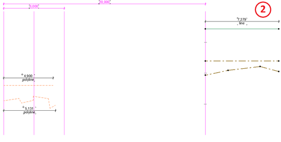

1. One line, 2 polylines at 27.279m long & a further 2 shorter polylines. I want to adjust these lines to the distances: 20m, 6m & 3m (un-labelled)
2. selecting the line & both longer polylines & adjusting it to the 20m line results in an undesired outcome.

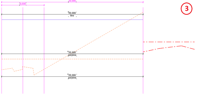

3. using the Adjust tool individually between the line, & the 2 polylines separately yields OK for the line, but both polylines are still incorrect.
4. adjusting the both shorter polylines at the same yields the desired result.
5. Adjusting them together to the 3m line is broken.
6. & adjusting them individually to the 3m line is OK for the straight line, but not OK for the one with the multiple nodes.
