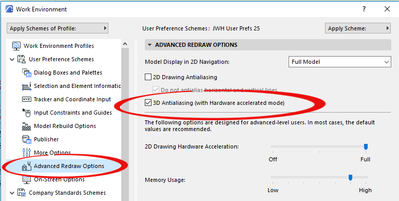

Is 3D anti-aliasing turned on in your Work Environment?

FYI: For whatever wicked reason GS deciced it would be great to disable this option in the OOTB work environment from v25 on.
