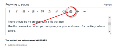

@pdiune wrote:
I am not able to upload a screenshot.  Is there a limit to the file size that can be uploaded?  The file is only 155 KB.
There should be no problem with a file that size.
Use the camera icon when you compose your post and search for the file you have saved.
And so I just found if you are using a screen capture program, you can just copy and paste the image.

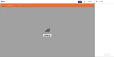

This is the error I get when I try to upload the photo
Anyway, here is the image of the dimension bug
