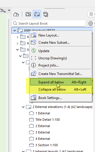

I am writing to report a performance issue I am experiencing in Archicad regarding the Layout Book.
Issue Description: When working with a project that contains approximately 1,250 layouts, executing the "Expand all below" command causes Archicad to freeze and become completely unresponsive to any input.
Specific Symptoms:
  • Although the application stops reacting, the Windows Task Manager does not display a "Not Responding" status for Archicad.
  • After waiting for about 5 minutes, the process finally completes, and Archicad becomes usable again.
  • This exact same issue occurs in Archicad 29 as well.
  • In contrast, executing the "Collapse all below" command works perfectly without any delay or freezing issues.
Could you please investigate this performance issue?

Leave it overnight and see if it finishes. Might be some odd quirk on how it expands the data tree creating some small inefficiency which is unnoticable with a more moderate number of layouts, but system grinding with larger numbers. If this was not an issue prior to AC27, maybe something to do with how it indexes for the search function.
It is a new right click context menu command that was introduced in 29.
It only seems to freeze for me if I first collapse all from the menu.
If I manually collapse them with the chevron, it does not seem to freeze at the end.
But that may be because I am only collapsing the main folder and the folders inside those are still expanded.
