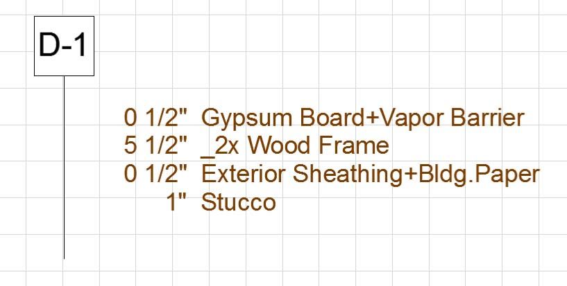

Archicad Wall labels will list every skin of your composite wall.
You can leave the label on the wall or you can move it off to the side as in the attached image.
Of course, since you created your own fills, etc, it will list all your custom work.
