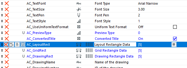

Hi Erwin Edel,
for layout sizes you can use
AC_DrawingRect to give the drawing frame
and
AC_LayoutRect to give the usable layout rectangle relative to the drawing
so you can produce a table to determine the standard sheet sizes available area(less the margins) to automatically say the sheet size.

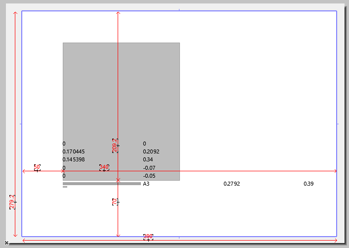

!!!Option for output
text2 0.1,0,sheetsizename
!!!this bit to show you the values, not needed in final script
text2 0.2,0, usableLayoutSheetHeight
text2 0.3,0, usableLayoutSheetWidth
for j = 1 to 5
   text2 0,0.01*j, AC_DrawingRect[j]
   text2 0.1,0.01*j, AC_LayoutRect[j]
next j
and combining the first answer to paul, you get:
ss = AC_DrawingScale
n = SPLIT (ss, "%n:%n", num1, ss1,num2)
text2 0,0, "Scale\t1:"+Str(num2,1,0)+"\t@"+sheetsizename+"\t1:"+Str(num2*2,1,0)+"\t@"+SheetSize50percent
Note: if you change the layout size, the AC_LayoutRect will only update after you update the drawing
I hope that helps too.

Thanks @AllenP
A good tip with detecting the source layout size - one less user input required.  User would still need to select a preferred alternative output/printing sheet size manually, since the same layout is printed to different page sizes for different purposes (A3 being most typical)
Had no luck with the split function to extract the placed drawing scale denominator - I can even copy and display it, but the data in that variable kept triggering wrong data type errors wherever/however it was otherwise used, whether treated as a number or text.
The looping digit by digit approach I ended up using not very elegant but does seem to work though.
