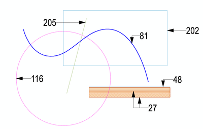

Bug copying linework to worksheets in 27
there seems to be a bug where copying linework (lines, polylines, arcs, etc) from a story onto a worksheet changes the pen to something totally arbitrary - and it's not the same pen for different people. Anyone else noticing this?
